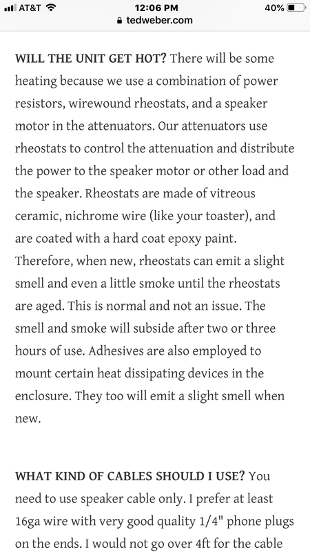

I was just researching the Weber miniMass attenuator on their website, and I came across this in the Attenuator Faq section.
The exact same wording @Ryan Kirk posted in his 2nd post on page one. So Ted Weber also talks about smoke coming from HIS attenuators when new. It’s a normal occurrence.
So it’s not just a burning Bugera thing like some uniformed members stated!! :nono:

Do you even read posts before you respond to them?? Or maybe you have difficulty comprehending cogent sentences!
What I posted is from Ted Weber’s website,..... referring to his Weber miniMass attenuator. He’s explaining that his product will get hot, emit a slight smell and even a little smoke.
